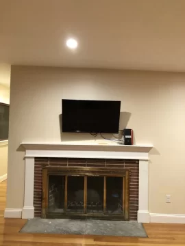

Did you post a picture of the fireplace and hearth? It would help a lot to see it.

Here is the fireplace and hearth.
  • [Hearth.com] The saga continues... getting the chimney ready
That's helpful. The flush hearth and low mantel are top issues showing. An insert is looking more attractive. Take a look at the Jotul C450 and C550 and maybe the Quadrafire Voyageur. For a nice unit look at the Enviro Venice and Boston.
I’m already planning a heat shield to make the clearances in spec. Can you explain why the flush hearth is a problem? I thought you need just 16” from door to a combustible floor?

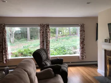

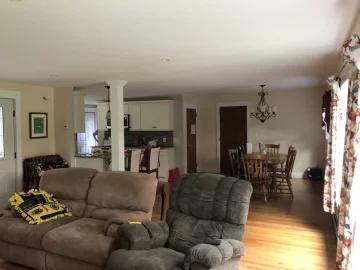

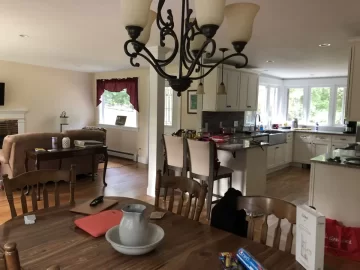

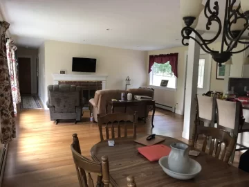

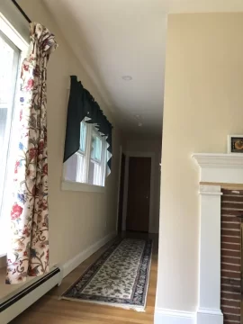

The total area of the house is 1400 sq feet. The house is mainly open concept no doors or any walls from living, dining and kitchen. Then there a hall way that is to the left of the fireplace and the bedrooms are down the hall a little ways with the master being the farthest away. I’ll post a pic later tonight or tomorrow.
One photo is from the living room to down the hall. And the other one is the living room, dining and kitchen taken from basically the hearth. 3 bedrooms and a bathroom are down the hall.
A few more....
And big windows.
A small fan on the floor running on low at the end of that hallway will push cold air back toward the stove, bringing warm air back to the bedrooms.
With 1400 sq ft, big windows, and short loading the stove with lower BTU wood, I think you will be fine with a small or mid sized stove.

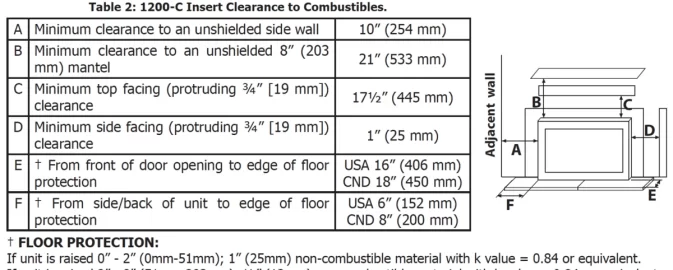

If I go with the enviro Boston it is going to sit on the hearth. The Boston sticks out 7.75” and my hearth depth is 17”. So would putting a hearth pad infront of the insert to extend the hearth be what I would need to look for?
Yes, It will need a hearth extension. The simplest option would to be to buy a hearth pad of the proper insulation value. It needs to be K= .84 or R=1.19 for a flush hearth. 18" wide is a common hearth extension pad dimension. It can go right up to the front lip of the stove. A little more complicated solution would be to remove 8" of floor in front of the current hearth and extend the flush mantel with an extension that remains flush. This would take a combination of an insulating material like micore and a hard covering like metal, or tile.
You will also need to check the clearances to the mantel.
