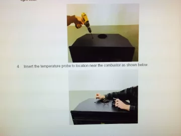

This insert has the option of installing catalytic combuster temperature probe, it's mentioned in a last pages of manual. You got to drill hole in designed place , not sure if I like the idea of drilling holes in it.
  • [Hearth.com] Thermometer placement
