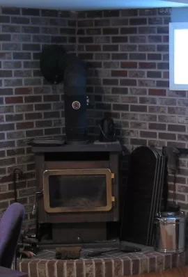

As for a temp alarm, I had a unit for use on single wall pipe - small 3x2x2 inch box. Took a 9volt battery, and squaked whenever the temp hit around 850*F. Bought it at a stove store for 6 bucks about 6 years ago. It is on the right side of the flue in this pic of my old stove (never knew what brand the stove was - stainless firebox and poor air control though.) If I find the unit again, I'll post a better pic.
  • [Hearth.com] Thermometer popped off stove pipe
Interesting on the 9V battery operated sensor. I'm surprised that the 9V battery could endure anything over 300F!
