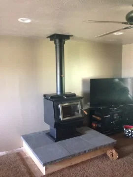

I own the linked probe meter for the double wall on my princess. It is mounted per the instructions 18" above the stovetop. First you drill a 3/16" hole all the way through both layers and then open the outer hole up to 1/4" for the grommet. It's all easy and clear in the instructions. Just be sure that you hold your drill level and square to the room so that the meter faces properly.
Accuracy matters. The redline for chimney is 1000 degrees. I regularly bumped that number when I was using the meter above my hearthstone. Man that stove wasted a lot of heat up the stack. Low cruise was at 800+
On my BK the flue temps when cruising are barely in the "normal" range at 400 up to about 600 when I'm jacking around with higher burn rates.
The probe meter from condar is made for double wall pipe. The probe is just a solid piece of copper with the purpose of conducting heat to the dial where the bimetallic spring is. Don't worry about cutting the probe to fit.
  • [Hearth.com] Thermometer: stove pipe vs. stove top

Same set up here. I too was astounded by the temps you were seeing. Our stove reads about the same as what you are seeing. It doesn't get above 6-700F in the flue unless I have a space out. With a timer nearby that doesn't happen too often. Normal cruising is about 100 to 150F below stove top temp.

Your new hearth is looking good. Nice job
