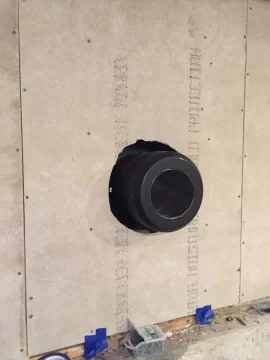

The thimble is in.. Got the frame mounted around it and the roxul packed in between except around the thimble as it requires an air space. Had to switch out my 5" snout as it was too short for the thimble. Installed the snout that came with the thimble using some wire to pull the strap back around the liner inside the chimney. I cut the snout to the final length of the thimble and ran the stove pipe right into it. I dry fitted things to see how it would work out and it seems perfect. The clearances from the back were exactly where I needed them. All that's left is to get the rock board over the foundation wall, figure out how i'm going to put as a ledge and put up the veneer stone. Hoping to get to that soon... Been busy around here..

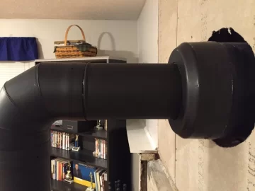

The thimble is in.. Got the frame mounted around it and the roxul packed in between except around the thimble as it requires an air space. Had to switch out my 5" snout as it was too short for the thimble. Installed the snout that came with the thimble using some wire to pull the strap back around the liner inside the chimney. I cut the snout to the final length of the thimble and ran the stove pipe right into it.....
Did you need to crimp the end of the TEE SNOUT to accept the black stove pipe?
No. I just got a 12" stove pipe connector that slid right into the inner of the T. So the end of the stove pipe was crimped and not the T.
that is backwards the snout should be crimped.

Ugh.. I just can't get this stuff right.. So how do you recommend I fix that if the snout is cut level with the end of the thimble..? Would something like this work so I don't have to redo the snout?

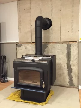

Okay guys.. now that the other projects are done I'm back to getting the wood stove finished up. I'm trying to figure out how to keep the back wall non combustible yet get it to level up with the finished drywall on the sides of the stove. I have about 2" total to build the wall out over the foundation wall for it to be level with the drywall on both sides of the stove. I've looked at metal studs however sideways they are only 1.25" wide. Anyone have any ideas? I would greatly appreciate it. I would like to be around 8" from the wall which should be fine as long as I don't add anything combustible. I will most likely be putting stone veneer over the concrete board.
  • [Hearth.com] Thimble Required?
Thanks begreen. Looks like that should work. Would it hurt to put Roxul in between the metal studs before I mount the concrete board or should I just leave it open air space?
Roxul is fine though you'll need to peel it down from 3 1/2" thick.

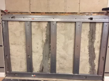

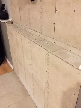

Well I got around to installing the steel studs. Got those all mounted to the foundation wall. I decided against putting Roxul behind the wall and just left it open airspace as i didn't think it would benefit me much. I got the concrete board mounted to the wall as well. I decided to just double up the hardiebacker board to get it even with the drywall on both sides instead of going with furring channel. Should land me right where I need to be. The pictures only show the first layer on the wall. I plan to finish up the 2nd layer tonight. I also need to put a little bit of hardieboard on the top of the foundation wall as I plan to put the same stone I use for the hearth on the top of the foundation wall as a ledge. Just thought i'd share the progress. Thanks again for everyone's help throughout this process.

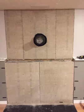

I got everything finished up last night. The two layers of Hardiebacker ended up being perfect to match up to the current depth of the drywall. I also got the upper part of the foundation wall all boxed in. Looks like i'm ready to bug the wife to figure out what color venner stone and hearthstones she wants! :)
