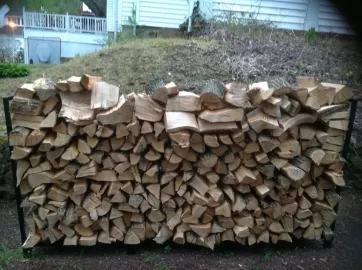

Where did you get that rack?When I scrounge and get rounds a full pick up truck is equal to 1/3 cord...... I am sending you what a full 1/3 cord looks like when split and stacked, each split should be 16 in longView attachment 129081...
