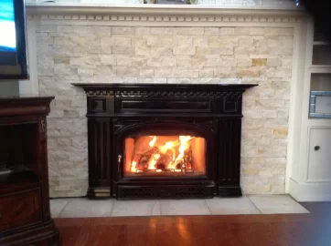

Whatever you do, don't get an insert with no fan, worst case you don't have to turn it on.... I use mine all the time on low... Here is a pic of mine, it has large glass area... All my wood is free, don't worry about the electric.... [Hearth.com] Thinking about an insert

Ram, that Monty looks beautiful. I would love to redo my brick fireplace to look like that someday.
Thanks, it wasn't expensive, $180 for the brick, $20 for the mud, $100 for the guy to make all the cuts with his saw, 5 hours and we were done. It looks totally different then the crumby red brick that I had.....
