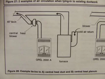

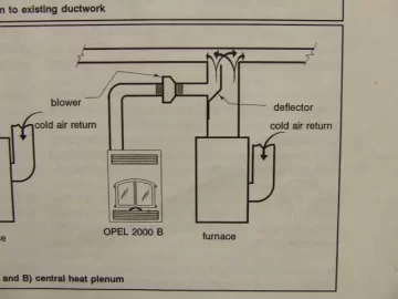

My opel is about 7 years old but here are the pics in my manual.Mine are lil bit to far from the plentum .The closer the better

Thanks for the diagrams! Im unshure if I should use the central heating option now. If I did I would have to run about 25 feet of ductwork to plumb into where its suposed to enter, then the heat (well, whats left), would have to travel 25 feet back the other direction back to the vents. I wander how this would effect it?
