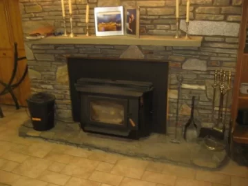

I guess I got the bug for a new stove, I think I could get better heat from a free stander and I think I could do it with little work, opinions on what needs to be done and what stoves (something close in size to my Princess or bigger) would work. My hearth comes out 18 inches but I can extend that easily and there's no combustibles since its a basement floor covered in tile.
here's my current set up\\ [Hearth.com] Thinking of going to a freestander

I would run the Princess without the surround for a little while as a test of how a free stander would heat. If and only if you have a block off plate.
Good idea, I do have a block off plate with roxul behind it. You think that would similate a free stander?
Don't see how it wouldn't. The heat has to go somewhere. Convection will set up in the fireplace like a free stander like mine does.

I run my stove with out the surround and it lets the heat out instead of it trapped behind the surround.

I have the stove in the FP in the lower level (about 1200 sf) near an open stairway to the upper level (1800 sf) the stove is in the middle of the house, Im heating more than the stove is capable of, I thought a freestander may give me another 10+% or so. If I was only heating 2200sf or less I wouldn't have a problem, as it is I only use one tank of oil a year, was trying to get it even lower. I'm going to try with the surround off and see how that does.
