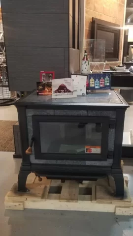

Thoughts? Heritage collection 2019 left over
LGMC
Dec 30, 2019
19
MD
Hi..female...have mercy....
Just started shopping for a stove bc our new house is propane $. Keeping the house temp at 60 deg. Using 3% propane a week which is good, freezing butt off (but ok, overall with clothing). Stopped by a stove shop and the guy was excellent with info. But, being at step one for research, afraid to a pull trigger wo a tad more research.
Hearthstone/ Herratage soap stone largest one they make...2019 model $4000. Guy said the 2020s are more EPA (dual something) but said less efficacy bc EPA. He raved about this and the 2019 model. I believe him....but let's get a few opinions plz.
This is the deal. House is 4400 square feet first and second floor combined with open floorplan and open two story family room. Basement is unfinished. This stove would go in the basement.
Is the 2019 better before the EPA installed stricter guidelines in the 2020 as he stated? EPA guidelines make the 2020s not quite "as good"? Not for the environment, I mean for the consumer.
Is this a fair deal? $4k for the 2019 delivery included (live in a $ area). Soapstone ok? He bragged about it. Size ok for our house? Again, this was the larger stove of the Herratage. The smaller one, same style, was quoted $2800 ...55,000 btu smaller one (2019 model). Heratage.
Thanks for any feedback. I did search and read before posting. Looking for specific info for my situation. Thank you

The heritage is just 2.3 cubic feet. Not large and also not the largest from hearthstone which would be the equinox at over 4 cubic feet. There is also the Mansfield which is between.
I burned a heritage for many years. The soapstone causes more harm than good. It looks great butis not a good material to make a stove with.
4400 square feet? You need a much larger stove. Really can’t get too big.
Reactions: LGMC

That doesn't look like a Heritage. The largest stove they make is the Equinox. Is that what you meant? That's what this stove looks like.
Heating 4400 sq ft is probably too much for one stove, even in Maryland, but it will make a notable improvement. This stove requires an 8" flue which will cost a bit more for installation.

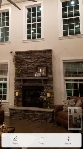

Attached a pic of our current propane fireplace. Originally we were just talking about buying wooden insert as I mentioned, and taking it from there. Somehow we ended up moving to discussing then stove in the basement since the sales guy said it when heat our entire house with ease (and not take up room in the family room).

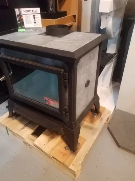

Thank you. There were two sizes of Heritage at the store the salesman showed us. Both were soapstone and both were the 2019 models he had discounted. I took a picture of the smaller ones display tag (pic attached). This was the first one he was trying to sell us but I was concerned that the BTUs were not higher (we might have still been discussing keeping this in the family room with the sales man at the time versus moving to the basement). Then he showed us the larger counterpart at $4k discounted. Was the exact same but larger (2019 leftover also).

You guys sure know your stuff! I called the store. The larger soapstone was the Equinox (at a discount to be 4k, lol....)
Aesthetics is not important at all. I think then soapstone is not the best choice for ours situation.

You could fill part of your needs with a wood burning insert in that fireplace! That may be a good place for you to start, and move on to the second stove when ready. (And at 4400sf, second stove is happening anyway if you want to heat 100% with wood.)
Looking at the photo of the interior of the home, a large part of that 4400 is double tall so you are heating the eqivalent of much more than 4400 SF. My ceilings aren't even 8 feet tall!
