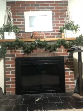

Whats the general consensus on buying used Inserts? I currently have a fireplace in my home that never gets used as it take 6+ hours to heat up enough of the chimney to start adding heat into my basement and it pulls in so much cold air the rest of the house gets cold. Ive wanted to get an insert for a while now but its just too cost prohibitive to buy a brand new insert. I recently found a used wood insert on Facebook marketplace for a steal, its going to cost me more to buy the chimney liner cheap. It looks like its a Napolean Oakdale model but I'm not entirely sure when it was made or the specific model number. It looks like everything is there, and would be a fantastic upgrade for my home. It looks like its in relatively good condition for the age but I have not gone to see it in person yet. I did have the seller measure the unit and I checked my hearth, and I believe it will fit, but I will also double check that as well. Do inserts have a shelf life or can you burn them until they fail?

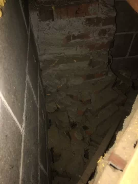

Back with pictures as promised. I’m going to split my reply into two sections just so I can explain each picture. I had originally though the chimney terminated into my hearth as is typical of many homes. However the upper section of the brick mantle upon my surprise is a facade, and removing the ceiling tiles revealed what actually is behind the hearth. This makes things both easier and more complicated depending on what I think I can do.
Also, since the glass doors are tempered and my house is old, I don’t use the hearth at all.

So I popped off the ceiling tiles and took a look as to what the situation was. I must say I’m fairly embarrassed that I incorrectly assumed the chimney terminated into the hearth. What I see when I look is to me, well scary. This house was my childhood home and we use to, years ago have fire in this hearth with this arrangement. What I didn’t account for is the block wall dividing the chimney from the hearth. I guess I figured the block wall terminated at the chimney, but that was incorrect. So obviously now I have a problem. There is no way I can snake a flex liner through the throat of the hearth and then through an 8” block wall and another 4” into the chimney no matter how much brick I break out of the hearth. However it occurred to me that a much simpler solution was now available. I could break out the throat of the hearth and the masonary connecter going through the block wall. This would make a large opening in the top of my hearth which I could then connect my insert through. I could also break out a “window” in the block wall, and then frame the window with angle iron just for support, so that I only have to go trough the 4” or so of brick in the chimney, which I could easily do with one of those t-connectors that come with the flexible vent kits. Now, im not entirely sure if having the top of the insert open to room air is ok, which is my first concern. My next concern is, or rather question, is because this is inside the house, would it be better to run double wall stove pipe from the insert up to the thimble or t going into the chimney, or should I just use flex liner here as well? I figure a stove pipe would be more ridged and safer, but it’s not stainless. I suppose I could use stainless here, but would I need double wall or is single ok? All 3 sides are non-combustibles, which makes me inclined to believe I can just run single wall stainless. I was somewhat concerned that having the top of the insert open to the floor joists, even if they are far enough away, was somewhat concerning. I could fabricate a 3/16 steel plate to sit 2” above the thimble to act as a heat shield. As far as the brick is concerned, it won’t be going back. I think if all pans out, I will fabricate a steel door in place of the brick. This will give me access to the thimble and insert when I want to sweep my chimney and I can keep an eye on basically the situation back there if I need to.
I know, it’s a lot to post, which is why I was contemplating just calling out a WETT inspector to take a look at what I have and let me know where to go from here. What I don’t want to happen is to rip out all this masonary only to find out that I can’t do it that way and now I can’t use the masonary hearth either. I don’t want to rip the entire thing out of I can help it.

I don't know Canadian codes but I am pretty sure you are going to have to tear that whole mess out
I'm sure even Canadian codes and the old manufacturer's instructions require the insert to go into a properly built firebox and as you've properly determined.....this one ain't. Seriously though....tear the entire thing out, put in a proper thimble, install an insulated stainless liner, sell the insert and make at least 50 bucks on it and go by yourself a nice freestanding wood stove. If your dogs have half a brain between them they'll know not to stick their nose or any other body part on a hot stove. Hell, even our cat figured that out and he's brainless.
Opportunity for a solution! Start over. Ditch the boat anchor insert and get a decent freestander installed properly. Common sense. Be safe. Enjoy.
