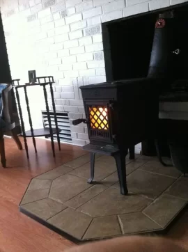

![[Hearth.com] Tiny wood stoves? [Hearth.com] Tiny wood stoves?](https://www.hearth.com/talk/data/attachments/74/74786-c5a10fa7373a8b81a0bd438ada4aaf99.jpg?hash=5RGgWv5Zp2)
They used to be around a thousand. Call a local dealer to get current pricing.
Pass. You want a small stove right?
Have you looked at the Morso Squirrel?
