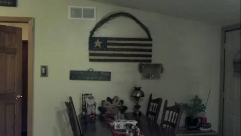

Installed... Dad came over and we got it wired. Just had to finsh putting wall plates on and cleaning up when I got home from the kids Scout meeting...
Running the Quad tonight so I can get a good baseline (have a register from Fahrenheit in our room. Will report back tomorrow. Tonights supposed to be pretty cold. Right now reading 13* outside on both weather stations.
Initial observations are its at least 3 times quiter than the Broan #512's. Although its less output (Broan 90CFM and Aireshare 75CFM) the Broan is a little overkill for a bedroom. The recycle rate on the air, should still be pretty good.
The switch is the one on the left (right next to my dresser) instructions were simple. The cut-out's provided were spot on for hole sizes and the thing is just quiet. Flat out quiet.
