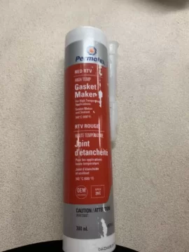

This is all I’ve ever used and never had a problem...11$ and 650f
  • [Hearth.com] To Caulk or Not to Caulk?
