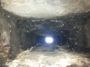

  • Pic 1 [original.jpg] is its 'clean and pristine' condition prior to us moving in and installing a small Buck stove into the living room fireplace. The bedroom fireplace is sealed up with plywood and aluminum tape. Looks awful but is only temporary. The Buck produces heat well, burns seemingly well and circulates that heat very well in the living space. We've burned probably 2 cords since November of seasoned oak, maple, hickory and ash. Seasoned as in tops remaining from logging operation in 2012 that I've cut up and split since fall. (Still need to buy a moisture meter to determine HOW seasoned, right?)

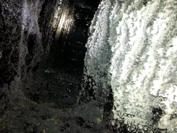

  • Pic 2 [plate.jpg] is a steel plate I installed about smoke ledge height inside the chimney; used a hammer drill and TapCons into the limestone blocks, then boiler mastic to seal the edges well. A 18" piece of black pipe (with round damper installed just above the stove ) runs from the top of the stove through the plate and extends about 6" above the plate into the chimney. The chimney has another plate and cap mounted on the top.

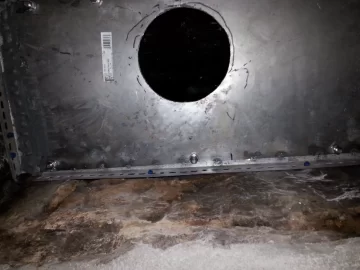

  • Today, I removed the stove and pulled down the short section of pipe from the lower plate. WOW! See pic 3 [now.jpg]. MAJOR stage 3 creosote from about 2' above pipe tip to the very top of chimney.
  • So my questions: I still intend to install the 24 gauge 6" single wall black pipe running back through that lower plate and connect it to a cap at the top. No way can I afford a SS liner outside that and double-wall pipe is out as well. Should I be concerned at all with all that creosote? Can it ignite simply from radiant heat from the pipe inside the chimney? Your recommendations?
