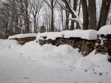

    Top covering and no covering both have some advantages depending upon your climate. Imagine the stack below without covering and that was just from one snowfall. We top cover but not the first summer. We typically have our wood split and stacked by now and leave the stacks open until late fall or early winter when we then top cover them. They stay covered until moved into the barn and we usually move the winter's supply into the barn in October.
