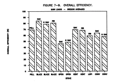

Here's a chart taken from a study that was done in the mid-80s. It compares the results of several test burns using both green (41% MC) and seasoned (20% MC) oak in a conventional airtight stove, and in the same stove burning with the doors fully opened (appears to be a Vermont Castings stove, although the brand wasn't mentioned in the report). The stove burned with less than 50% overall efficiency with seasoned oak while open, but about 65% overall efficiency with the same wood when burned as an air-tight (doors closed).
The author of the study defined "overall efficiency" as the heat output divided by the total potential heat in the wood. The potential heat of the wood was determined using the "low heating value" figure, which neatly and conveniently accounts for all of the heat lost during the various water vapor transformations. These were eliminated from the equations since they provide no sensible heat inside the living space. This is the only realistic way to define efficiency, since it accounts for heat transfer as well as combustion efficiency and heat lost due to unrecoverable condensation of water that occurs outside the flue.
Curiously, the open stove had slightly better overall efficiency with the green oak than it did with the seasoned oak while burning in the doors-open manner. Even more interesting is that the author mentions that the stove produced only 1/4 of the amount of creosote while burning the green oak at a high burn rate as compared to the seasoned oak burned at the same rate, both burning while the stove was in the air-tight mode.
