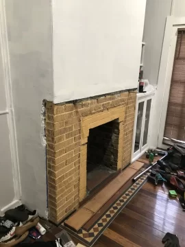

I want to install a stove but I’ve run into a problem and I hope you guys can help me sort it out. I have an existing internal masonary fireplace ( the back of the fireplace and chimney back onto a wall of a bathroom behind it. One salesman tells me if I install the stove inside the fireplace I will only get about 12% efficiency as heat rises and all the heat will disappear up and out of the chimney. He advised that putting in a lower block off plate at the base of the chimney made of compressed cement sheeting and topped with some kind of insulation would have little effect and I’d be wasting my money. He says I should only consider an inbuilt fireplace with a fan and that will bring efficiency up to around 65%.
Some background. The house is old ( built in 1950’s?) and not very thermally efficient at all. Has some ornate plaster ceilings, lead light glass and coloured glass and that’s why we wanted a fancier (IMO) stove rather than a plain inbuilt fireplace. We had chosen the Jotul F 8 as a stove before the salesman threw a spanner in the works.
So we have a few problems : If we bring the Jotul into the room and use the back flue hole and run the flue into the fireplace horizontally and then up the chimney I won’t be able to mount a TV on the chimney above the fireplace as it will get too hot. But I guess this would sort out the heating problem? Also the room the fireplace is going in is small (3.7m x 3.7m x 3.25m high) so the stove would take up valuable real estate. But the stove/fireplace still needs to be able to heat the rest of the house.

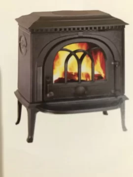

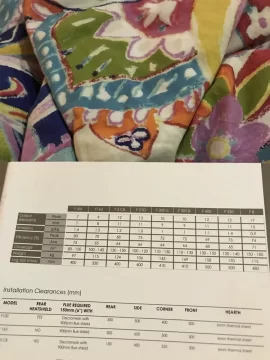

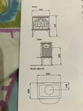

Hi begreen. Thanks for your reply. The only info I have about the stoves make and model is that it’s a Jotul F8. I’ve added some pics of its dimensions and characteristics to see if that helps. It has a peak output of 17kW.

The F8 was the predecessor to the F400 Castine in the states. It is a competent, 11kW peak stove, but somewhat old tech as far as efficiency goes. It also lacks a blower option. A radiant stove like the F8 will work, just not as well as a convective stove with a blower.

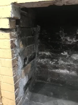

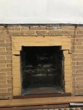

What is the size of the fireplace opening and depth? Have you looked to see if the Lopi Rockport or a PE Alderlea (T4 or T5) would fit? They have a blower option. The Alderleas are also available in inbuilt models.
Also, the room is small for a wood stove so it's important to know how open is the fireplace room to the rest of the house. Is the general floorplan open or closed off by doorways? If heat will not easily convect to other parts of the house, this room may get too hot in the mild climate of NSW.

Lopi Rockport and Anderlea T5 and too big I think plus the Rockport is a little over my budget. However the Anderlea T4 might do the trick perhaps. I need to do some more research. My house is roughly 160m^2 (1700 sq ft) I think. Adjacent to the fireplace room is the kitchen/family room about 7m x 5.3m x 3.25m high joined by a double sliding door approx. 1.77m x 2.05m. Everything else comes off these 2 rooms and is all doors and hallways. The size of the current hole for the fireplace is 700mm wide x 760mm high and 500mm deep. I can renovate the hole to about 1.12m wide or slightly bigger and I think that’s what the installation requires. However I’m not sure of the height requirement yet to the top of the fireplace and then mantle. But the depth may be a problem as I want the TV above the fireplace and I’m worried rising heat would destroy a TV mounted above.

Oh and I forgot to add that the installation manual for the T4 says the minimum clearances can be reduced if surrounded by non- combustibles but I’m still trying to find out what those clearances are.

The T4 sounds like a better fit. You are in a mild climate and the heat is going to want to stay in the room. A ceiling fan will help a bit. Is there a mantel on the fireplace? That could be a clearance issue unless it's non-combustible. Can you post a picture of the current fireplace wall?
Reactions: bholler

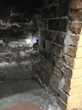

A ceiling fan is definitely going in when the electrician comes. There is no mantle on the fireplace currently. I took it down when I pulled the inset out. It was at the join between render and tiles which was about 1.14m above floor level. As you can see I’ve got some work to do. I was goin to re-tile the bottom section if it worked out the mantle was about there but depending on it’s location I might have cement render all of the lower section? But I was going to put in a great lump of wood for a mantle maybe 8 inches deep in the fireplace sticks out from the space. I should say the 500mm depth is when tiles are added at the bottom to bring the front level with the top rendered section. Here are some pics. In the 1st pic you can see to the right some French doors. When I bring the hearth up to fireplace level that may interfere with the flow of the room. Also found some old gas pipes after pulling out the insert! Arrrrrrgh! Lol.
Thanks for the pictures, they are a big help. Whatever stove is chosen, check the mantel requirements closely. It could get sticky with the Alderlea T4 because there is no tested data for clearances to a mantel. It is not normally installed in a fireplace. However, it the new mantel is non-combustible, then no clearances issue. In the US there are several good quality non-combustible mantel companies. Their products very much like real wood. Are there any in NSW?

Demolishing the fireplace is definitely not a consideration. I’ve already demolished one in the house and there was about 3 tonne of bricks. This one is way bigger and I think there’s probably 5 tonne of bricks in this one. Coupled with the soot and patching the roof and ceiling I think it’d be a nightmare! Plus I want a TV above it.

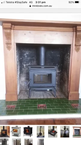

I haven’t considered a different mantle yet as I was always going to use timber so I’ll have to look into that further. I found an Alderlea T4 on a different stores website installed in a similar fashion to what I was thinking so I might contact them and ask what clearances they used.

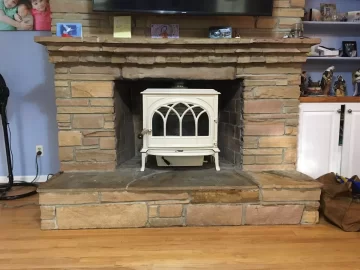

I like my cast iron Jotul F400 set in my fireplace. It’s is as far back as it can go but the stove could move back but the liner is preventing it moving further back. Some Jotul models have short leg kits. My opening is .75 m high by 1m wide. (I think I did all my conversions correctly)
Making sure you adhere to clearance to combustibles looks like your biggest job. And should be addressed not matter what you chose if you are burning in it.
I kept my tv above the fireplace. If I had it flush mounted it won’t get too hot but the stone behind the tv can get up to 38c after a long day of burning. My blockoff plate is not well sealed and I don’t have insulation above it. My stove heats 95 m^2 open concept easily and another 90 it keeps livable, but my climate is pretty mild -4 C is a cold night. Keep researching the best solution. I’m sure there is one available you just might not like the cost or the work it would require.

The code legality of that install is dubious for here in the states. Not sure what is required in Australia.
That non-combustible mantel works well and looks good too.
Here are some other non-combustible mantel options.
