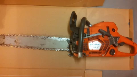

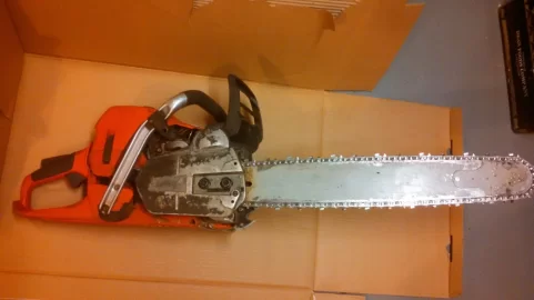

Anyway, here's the scoop on it.
Comes with 20 inch bar, and probably a bunch of chains. He doesn't run 20" anymore. 24 and 28 only.
Year is 2012, approximately 200 hours on it. Ran pump gas and 40:1 Husky oil it's whole life. My buddy actually owns the company (I didn't know this) and he and his brother run the operation. Was strictly a skidder saw, with the 'go to' saw his 372 or 390. It's dinged up, but we knew it would be, being a skidder saw.
He's a former Husqvarna/Dolmar mechanic at the local husky dealership, and said that he just put in a new carb, replaced the gasket (it was leaking) and while he was in there replacing the gasket, put new crank bearings in it.
Price is $325.
I think I'm going to get it, but opinions are always welcome for sure. Any reason why I should pass?

Looks like a good deal if it's running good. Did one of the plastic bearing cages let go?
Why was the carb replaced? Did it have the dreaded "hesitation" issues?
