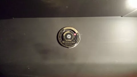

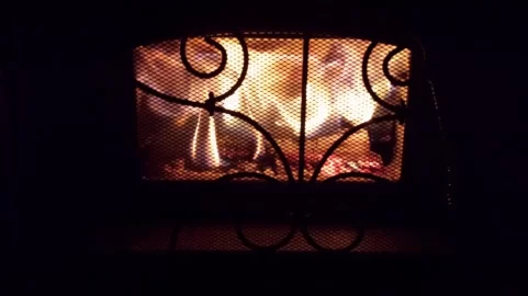

My stove on lowest setting right now.

What stove do you have there?
Normally, on a steel stove 700 is not to hot but getting there.
If you don't want to burn that hot try shuting the draft control down sooner or use less wood.
However, I have a feeling that since you posted the temps have went up some more and your to busy watching the stove to read this
Your stove should be able handle that heat 800 is too hot for me.
That thermo is in direct contact with the top of the fire box? That is warm...

I have not tested my thermometer. That is probably a good idea.
700 was sort of the peak. I leave it open until it gets up around 400 and then pull back to 1/3 till 600 then all the way off. I did stuff it full of odd pieces because I an trying to save the good stuff for the cold. Maybe too much air between the pieces?
My main question is when you are running at 700 with the air as low as possible it seems too hot. I think I will try turning it down sooner as suggested, but when?

It's hot but not dangerously so. Try closing the air sooner, around 400F. On a reload be sure to burn down the coal bed enough to avoid a large flare up. Take it down to about an inch or so.

It seems like you have a good handle on what caused it to get a little hotter than you would like. Those odd shaped pieces were probably a lot of surface area to off gas at once, as you suggested.
700f isn't to hot but I do realize it is knocking on the door and when you get there by accident with nowhere left to go with the air control it can be pretty scary.
Some people will open the air control or even the door (I would try air control first but even then, not until the stove is at 800f. Use your own judgment) to cool the stove. either should cool the stove by sending cool air in quickly and heat up the stack. The latter would do a better job of shutting down roaring secondaries I suppose but I've honestly not been in a situation where I felt I needed to do either.

Also, as mentioned above, those thermos can be off quite a bit. Still a fine reference for routine but not a good judge of what is actually happening. An IR gun can be picked up at the big box stores and are great for many things besides wood burning.

My rule of thumb is that I don't want the fire to change considerably when I decrease the amount of air available to the fire. With the Quad I after re-load I would wait about 20 minutes and then I'd be able to close the primary air control all the way and the fire would stay about the same. After another 20 minutes I'd close the secondary air about half way and that's where it stayed throughout the burn. The other side of that is that I don't want to miss those times either or I'd risk overfiring.
Put in smaller loads of wood in milder weather. The stove doesn't need to be filled to the gills in order to produce good heat.

650-750* is harmless to a steel stove. 850-950* is hitting the max limit. 1000-1100* and a dull red glow can be seen, and warping could happen. Seeing 650-700* with your air intake shut down, means your burning perfect wood, and most of your heat is staying in the firebox. My 14-15% MC wood burns in the 550-600* range for 2.5-3 hours, then slowly tapers down.
