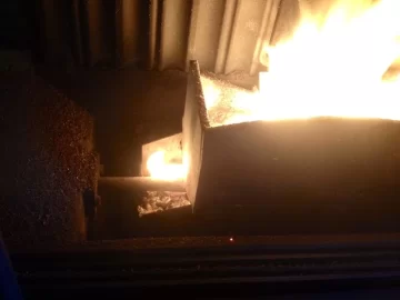

We're a couple of weeks in with our M55 FS and I have another question..
Pellets are pouring in and overflowing from the firebox, some falling to the ash pan before burned.
These Corinth pellets are smaller in size than the few bags we burned before this delivery (one offs from Home Depot while waiting for delivery).
I have adjusted the feed trim down and am using the premium setting. No matter, they just keep pouring in.
Is there anything else I can do?
I have a mag coming this week and we'll install our wireless Tstat this week as well. At this rate we may run through a ton of pellets before we get there.
Thanks, everyone! This forum is so helpful!
I just started it up about a half hour ago and you can see here that the pellets are already thinking about overflowing the burn pot. I cleaned them off of there before starting.

Close down the adjustable auger cover in the hopper. That will reduce number of pellets delivered per auger turn.

Is this only happening at start up? I notice the same thing with my Hampton GC60 but only at startup as it seems to take a while to ignite the pellets so there are plenty in the pan.
I would leave that auger cover where it is until you get the draft set with the mag. I bet when you look in there it will be at one of the lower settings. Also, do you plan to burn these pellets all season?
that picture looks normal compared to my stove. are you getting a lot of unburnt pellets or just a few? another cause of unburnt pellets is a bad draft, dirty basket blocks air flow and not all pellets burn.
but this stove does spill pellets from the basket.
