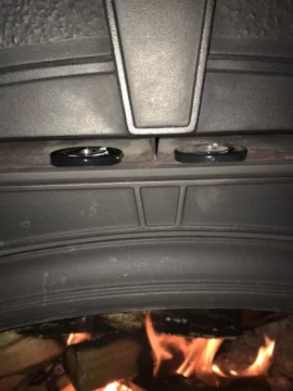

I have 2 condor magnetic therms as pictured above, which corresponds well with each other.
