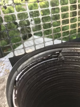

I noticed that my ss liner falls about half an inch from the top of the top plate termination. Liner is attached to top plate by clamp on top plate. Is this any issue? Wasn't sure if any creosote falling down from inside top plate was anything to be concerned by.
I recently had to re- attach top plate due to the original adhesive failing. I suspect liner moved down a bit when doing this. With it re attached now, I am trying to avoid re-doing this project. Thanks in advance

I'm thinking I will have to redo this so I can make sure liner ends above the top of top plate. I looks like the original install used Construction adhesive to adhere top plate to terra cotta liner. I didn't clean the difficult parts of that off and just put silicon over it and put top plate on the silicone. Seemed to bond well but afterward realized that now ss liner is about a half inch shy of top of top plate. How would I best take off the old construction adhesive (and the silicone) off the terra cotta liner without damaging the terra-cotta liner?

[Hearth.com] Top plate question. Want to make sure that the consensus is that it definitely needs to be fixed. Thanks in advance
And also, would a male to male coupler work? I don't much additional clearance?
A Top Plate will have a 3.25" tall collar attached to the top plate. There should be a band clamp about 1" above the top plate, that is what holds the liner in place. The liner does not have to go all the way to the top of the collar. Looking at your picture, it appears that you are fine with the liner being 1/2" short to the top of the collar top.
That liner is just fine. Rest.
