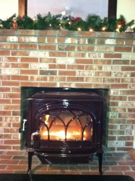

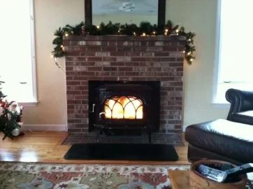

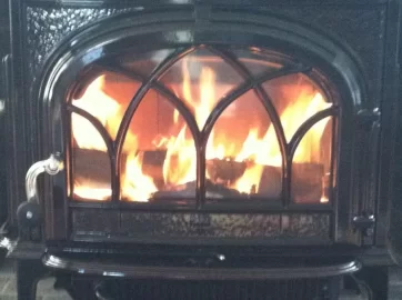

So I picked the brown enamel Oslo. It looks beautiful in the room but maybe it's me, but it doesn't start up really great. I will admit that i have had to open the ash pan a few times to get it started. I know, I know.....BAD! I am hoping the slow startup was d/t the temps still being in the 50's. I've tried to attach some pics....

Beautiful install! You mentioned start up is tough for you. How tall is your flue? Did they reline it for you and install a block off plate? What kind of fire starters are you using? Using the ash pan...Just an FYI that does void the warranty. And start up is the worst time to try and use it because the whole stove is cold and is super heats one spot.
Why not crack the door at start-up to aid in flow? I'm in my 2nd year of burning and my stove requires the door to be cracked for 90 seconds to 5 minutes. Doesn't matter how I set it up, quality of wood, etc....it just doesn't breathe well during cold start-up without the door cracked.
well, not sure about a block off plate (don't know what it is) , flue is about 25 feet. I know about the warranty issue so that is why i will not do it anymore. The installer said that he closed off the air going around the ss liner at the top of the chimney. It's still ok for me to keep the side door open for a short time while getting the fire started, right?
oh and I pay close attention to all the info I get here on the forum so I have been using super cedars for the start up.
ok...so I just measured my flu and it appears I was way off. It is actually only about 16 to 17 feet. I understand oslos do better with a taller flu. It never occureded to me to mention this to the salesperson when shopping for a wood stove.

Just give it a little time to get used to it the fire in the pictures look good.

I think your installation looks terrific, cozyhome, for the reasons mentioned in your post #23, above. And for the record, that would have been my choice from the outset...but it ain't my stove. You'll figure out the operating routine. Neither of my stoves has an ash pan, but I routinely leave the doors cracked for a bit on startup. Just don't EVER walk away from the stove with the door unlatched (or the ash pan open) for any reason! Rick
