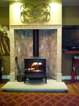

Here's my vote....
  • [Hearth.com] torn on getting green enamel or blue/black for my Oslo 500. Any opinions?
Pretty stove and hearth -- What are we voting on????
