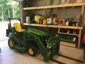

Sorry it took me a few days to respond to this thread my first born child was born last week and I wanted to get a chance to snap a few pics before I replied.
I have been using the totes for several years in conjunction with my John Deere 1025R for my firewood years.
[Hearth.com] Tractor size?
This 1025R loader is capable of lifting a little over 1,000lbs at full height, but it can lift more like 1,250lbs about 1' off the ground. I have done a bit of testing with weights and find these numbers to be pretty close. It goes without saying you need something like 80% of loader weight in ballast to be safe for the tractor and prevent dangerous scenarios.

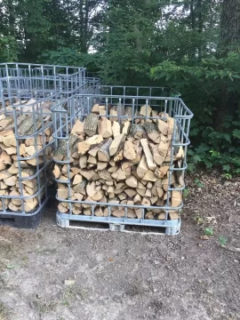

I have over 20 totes filled to the maximum capacity my tractor will safely lift (again about 1,250lbs I can lift only about a foot off the ground). Also note there are a few different sized totes, some are 270 Gallo dish and some are 330ish gallons. These are the big ones. I got them from a plastic recycler that shreds the plastic tote and sold me the metal cages for $5 cash. I had to shop around for several years to find this deal, keep your eyes pealed deals are out there, the food grade totes go for big money, peepers love them, they usually go for @$75 each in my area and that's not necessary for a firewood guy.

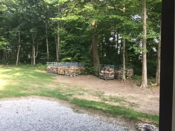

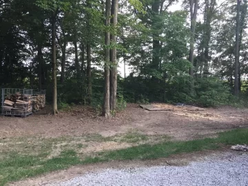

Here is a shot of my firewood processing area and a tote in the background. The totes get stored in a higher sun area. I keep them close to the splitter and use the pallet forks and tractor to haul them to their drying area.

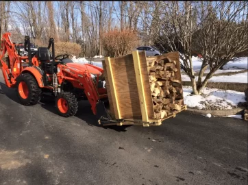

This was the little 25 HP, she could lift a pallet size load of *dried splits about a foot off the ground, ballast was key to keeping good traction.

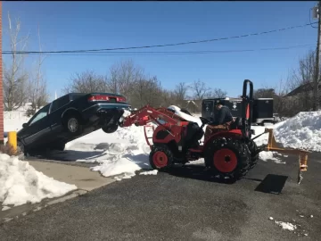

Mine is used mostly for spreading fertilizers, herbicides, and seed on the lawn, using a Herd M12 crop spreader or my 60 gal x 14' boom sprayer. But it's also a snow and wood moving machine, despite being only 25 hp.
Harvesting walnuts:
Setting up the tandem aerator:
Fitting up the mud and snow chains:, since I run turf tires for the lawn:
Drying off the snow thrower:
Stacking big rounds:
Collecting brush in fire pit.
It's a versatile machine, for my needs.
