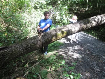

This red elm fell across my driveway yesterday. I can't figure out how to take it down.

Pull it flat with a truck or come along.
This red elm fell across my driveway yesterday. I can't figure out how to take it down.View attachment 348689
Time to pay someone? If that’s not an option this is what I’d do.
At about waist high high on the leaning trunk I’d make a face cut /notch making sure not to pinch the bar. Then I’d pick the safest side and complete the cut from the bottom up. Going to have to pull the saw out quick. I’ve done it on arm sized limbs. When you think you can pull the base with your vehicle do that. You might have to cut a couple more chunks off.

Do you have a way to reach the base if you step down the bank and be in a safe position so that you can hop away a few feet?? If so cut it from the top side, until it begins to crack. It will make several cracking sounds and then it will stop. At that point it should be less than half way through and if you are in a safe position to get away, lightly and I mean very lightly, cut into it an inch or less until it cracks again. Then cut below in order to allow it to fall slowly as you cut the right perhaps 24" upward (on the bottom side) away from the upside cut until it falls, going slowly with the chainsaw, and you'll need a minimum 32" saw chain.
As an added note you could spend an hour setting up a 2"x12" leap board so you have a safe way to maneuver away from an angled drop, though I can't really tell from here if it would do that, actually the pic seems to show a pretty mild fall straight into the bank. At that point you should be able to cut it into 6' to 8' lengths to haul away with a tow strap to get them out of the road
I am only saying that this appears to be the safest way to do this. But do not rely solely on my advice. The safest way is to hire a tree faller or a a professional Arborist
Hard to tell how big that tree is and how it's hung up, but i'd do the walking the butt like in the youtube above.

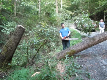

The tree was growing on the edge of a little creek. The creek washed away the roots on one side and the tree went over in a storm. Most of the roots are still buried in the earth.
The tree didn't fall to earth because it hung up on 3 or 4 small trees up on the bank. These little trees are 25 feet tall and 4 inch diameter.

Ya, I'm assuming the tree started falling and got hung up in other trees = tension on top. But if it just leaned over due to roots giving out = tension is on the bottom (tree is leaning but not hung up). So now the tension is on the bottom, start bottom cut first (into the tension) and finish it with a top cut. Yes it makes a difference whether it is leaning or hung up.
Suppose that tree hadn't fallen on its own. I finally found a video on chunking down a leaning tree. He cuts notches on the top (the tension is on the top). Then he releases it on the safest side with a bottom cut - chunk, chunk, chunk. Yes this is better than a straight cut on top because it allows the tree to fall down easier. I do a straight cut only because I'm trying to save the wood (my firewood). But this is better with a heavy dangerous tree like you had with that heavy walnut. At the end, he finally pulls it down with his vehicle.
