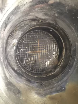

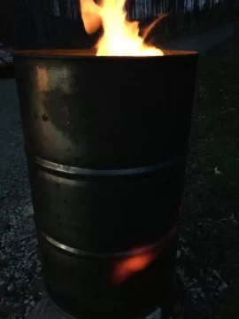

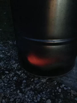

Any info or help/ tips appreciated here is the progress pics ( which is just me burning paint off). And hopeful outcome.

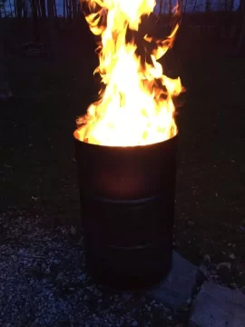

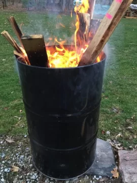

Is this what an over fire on a stove pipe looks like. Definitely hit it on this barrel

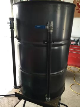

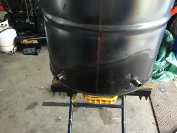

Don't know if anyone's even watching this thread but anywho. Here's today's progress. Got all the vents welded in

Thanks I will. Now I need more parts to continue. All in with the dome lid, grills, and basket I'll be about 200$. The old BBQ frame coming from a friend at work who does scrapping. Plus he's gonna give me his old BBQ for me to repurpose into a charcoal grill. Welding to the drum was quite difficult as its so thin and I haven't welded in about 5yrs.

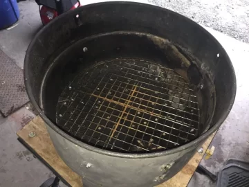

Here's the charcoal basket. Made out of my old vertical drum smoker that was destined for scrap pile. Just need grill and lid now and she should be functional by this weekend. Then to mount to frame and paint!!

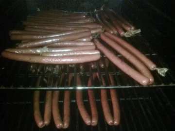

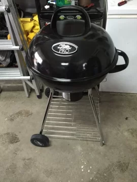

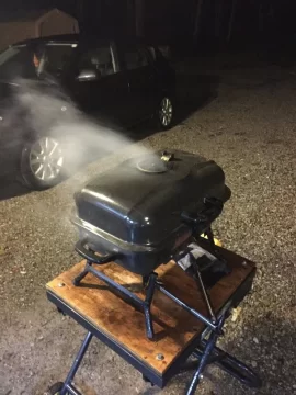

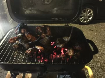

It will be charcoal. As its direct heating as the 1st grill will be about 24" above it followed by the (2nd to be added later under the dome lid. I went out today and bought a new kettle grill as they were on sale at the local hd for $74. Nice thing is I can use the grill and when I wanna use the drum just grab the grill and lid of it. I plan to get that grill assembled today and do sausage on it. Then do the spiral ham in the drum on Sunday!! Here's some pics from last nights wings I did on my tiny charcoal grill in the freezing rain!

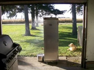

Nice is it charcoal or does that hose go to a propane burner?
In that pic it was sucking propane. I can also insert a charcoal bin and go that route, but whatever method I use gets hickory smoke applied to it.
The propane makes for a very easily controlled low temp environment (like 150F for 10 hours, for jerky and snack sticks).

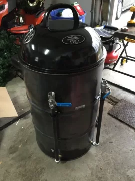

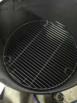

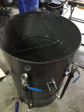

Amazing. Well folks got my new grill doing some sausage and drum smoker finished minus the frame and shelves
