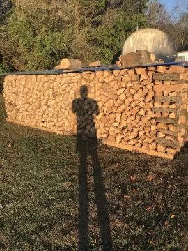

I use metal sheets of roofing on top. I drill holes in them and stake them down, and put big uglies on top. This allows the entire stack to breathe. I’m not a fan of tarps as they can trap the moisture in at the top.
Just throw pallets on top of the pile with the forklift pockets facing out. It makes a big difference in air flow up through the top of the stack. Then put the roofing on top of the pallet. No moisture problem.
