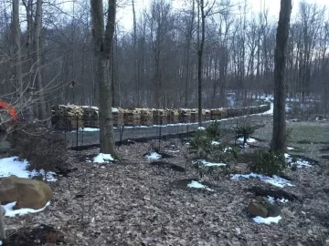

This is how I handle mine. It would take a lot of tarps! Covered before with 20‘ long sheets of corragated fiberglass. Big job to do and no matter how I did it it was trouble in a big wind. I’ve eliminated all the stacking and restacking.
At the end of the second summer the baskets are moved under cover with my tractor. I have Hearthstone stoves so I would know if there was a problem with the wood. They don’t like wet wood.

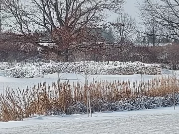

This is what I have going on currently with the stacked wood out in the elements....I plan on the wood shed in the same general area. It's a pretty windy spot with all day sun and feel tarps or sheet metal may be a tough task to secure long term. Thats about 10 cord stacked on pallets and the start of this year's harvest. I cut and process in the winter.

One year I had about 20 baskets covered with the corrugated fiberglass and then put concrete blocks,tires, and 6x6 blocks of wood on top. Wind blew it off. Used ratchet straps to hold it down one time. All of it was a lot of work. I got in to wood burning later in life. I quickly figured if I was going to continue to burn wood I was going to simplify everything I could. Stacking,moving,stacking again,covering,uncovering,restacking after stacked wood fell over,recovering after covering blew off. I’ve eliminated all of that and am happy I did!

I have uncovered wood older than that, and it’s fine. I just keep it off the ground and out in open air.
Do you have it stacked on pallets? If so do you have any trouble with your stacks tipping over with the multiple freeze thaw cycles and frost? This will be the 2nd winter for the stacks I started placing last year and I wonder about them falling over even if stacked well.

I stack it on old cinder blocks or bricks and scrap 2x4s. The stacks get wobbly as they dry, but I keep them under 4 feet high and have only had a few topple.

Looks similar here. The oldest here is from 2017-18. Mostly oak with some others mixed in. Sunny, stacked 3 deep, no cover. I haven't noticed degradation from the weather. Woodchucks from below, that's maybe understandable and another story. Been through covering with tarps (tears and rips), tin (heavy, not enough to cover it all, one hole concentrates all of it). Finally got lazy and left it all to the weather and found that even when snow covered and rained on, it didn't take long to steam and bake the surface moisture back off. I bring in this years supply under cover during the typical August drought. So far wood stays heavy and dry. Splits have a nice dry ring when brought in.
