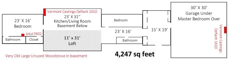

Our home is 4,247 sq feet and three levels. The stove needing replacing is in the main area of the main floor of the house. I have attached a layout of the house. We have a Jotul F602 in one bedroom and a smaller Vermont Castings Defiant 1610 (at least I think that is the model) in our Master Bedroom which is on the top level above the garage. We do have a very old wood burning stove in our basement (make and year unknown) but we currently do not use it as it has a very bad back draft problem.

As far as the Master Bedroom goes that is 30' x 30' it does not get heat from any of the other stoves in the house, it also has a pretty high cathedral ceiling, but the VC in there heats it very nicely.

The doors are both warped, it has a big crack on top and the damper no longer works. The house is insulated as well as it can be between every log, but the 8" log itself does not have a very good R value. Short of building a new house, really no way to insulate better.
When you have problems with heat distribution a small desktop fan placed on the ground at the end of the corridor (where the "19" is in your sketch) blowing cold air towards the living room should help a lot with moving the hot air.
So far with the setup we currently have the two downstairs bedrooms do not get heat when the doors are closed. We have tried fans every where. Hopefully with a better stove that will change.

I am not sure how to answer this. All 4 stoves have their own pipe chimney. I am a fairly handy guy, but stoves are out of my wheel house. To answer I will need a little more help.
