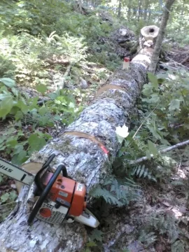

Mine is the humble wedge. And after yesterday, I think I might need to get a couple more.
[Hearth.com] Under-rated processing tools?
That's a 2 year old windfall that was sitting uprooted with the top against another tree all that time. Decided to tackle it this weekend. The root ball didn't fall back all the way of course, leaving the thing under serious compression the whole way. Things got better after I decided to move to the top end after it settled enough that I could safely reach things, after I managed to get both wedges quite firmly stuck. The first cut was a little tricky - but they saved me from a whole lot of struggle several times. Especially that first cut.

I did the same thing on my bar with a Sharpie, but the mark didn't seem to last. So I masked off a couple stripes on my bar, one each side, and spray painted it a couple weeks ago when I was painting something else. Can see that 18"" mark on my bar in the pic. Will see how long that lasts.

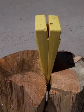

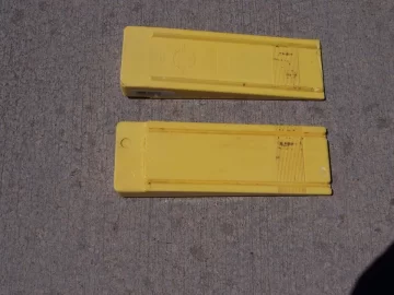

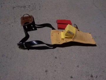

I would never go cutting without at least 4 wedges, especially if I am felling. I really like the Stihl yellow wedges that have groves that fit into each other so that you can pile them on top of each other and they will not slip sideways. It is really good to do that when you have very thick bark or rotten wood so you can get the wedging action deep into good hard wood.
