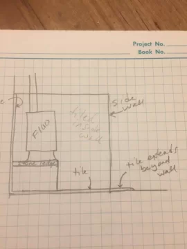

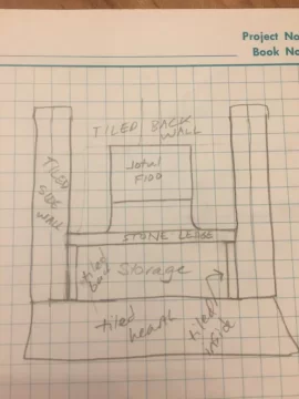

I am designing a wood stove installation in a new construction (addition to main house). Space is at a premium, and so I am trying to design space for wood underneath the stove. Due to other considerations, we will need side walls, and I was hoping to tile everything (over cement board) for ease of cleaning. So, tile for hearth, inside of side walls, and back wall.
My original plan was to have a steel box fabricated to use as a stand, but the builder suggested a stone ledge for the Jotul F100 (215 lbs.) I have drawn a rough picture of this concept. The stone ledge will have to rest on wood.
My questions:
Does the wood supporting the stone ledge (2"x15" total dimension on either side) need to be covered with cement board even though it will be under the stove, and not subject to heat?
Will a piece of stone support at 215 lb. stove the way it is drawn?
Is this a reasonable design/use of space?

Some people will tell you it's too risky to store wood under the stove and they have a good point. Personally, I've done a lot of far riskier things that I felt comfortable with - every situation is different. If I were short on space I might do that - but only if the wood was on a rack so an errant ember on the hearth couldn't get to it. And I would keep the wood tucked far enough under that embers couldn't fall on top.
As to the stone slab, stone is a natural product, as such it has variations, faults, etc. Some are easy to see, some not. I absolutely would not support a stove on a natural stone slab. That's not to say it wouldn't work but I wouldn't do it personally.
At the very least I would want some steel u-channel supporting the slab crosswise such that if the stone did fracture the stove would still be supported.

Thank you all for your valuable comments. The side walls are necessary because I have a family member with epilepsy.
One reason the builder suggested the stone slab is because the original plan was to have a fabricated steel box under the stove, but the stove seller said something about how the stove could slide on the steel if something/someone fell against it. We have a plan to secure the front of the stove (a spark guard that will fit into the ends of the wall) but the thinking was that stone would resist stove slippage better than steel if there were a fall. The builder specifically suggested "honed bluestone." Any comments about slippage?
Bolt the base of the stove to the stove support?
