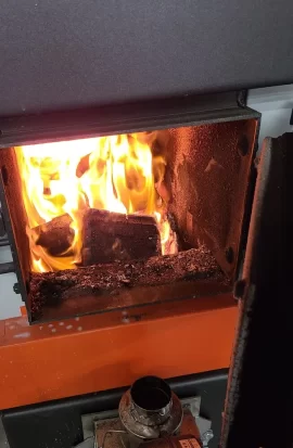

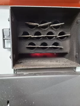

They aren't bad as people make them out to be. The pictures attached show batch burning with no secondary air... being that it is a pellet model it does not have the secondary and not optimized for burning cord wood. No visible smoke outside....
But as @brenndatomu mentioned above smoke is mainly a problem when going into a burn cycle or when heat is satisfied.
From what I understand the UNI does do a pretty good job... better than a smoke dragon but I agree that storage might be a must when using water cooled firebox with no brick lining.
We primarily burn pellets and it burns very clean. Exhaust doesn't smell at all. Nice to have the option if something breaks to switch to manual burn.
