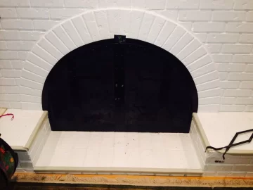

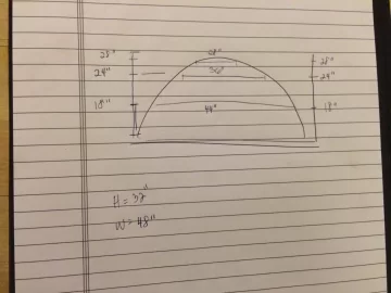

Dimensions as best I can explain(pics below):
48" wide in the front
37" wide in the back
27" from back wall to front of firebox
32.5" height in the center
39" from floor to ceiling inside the firebox
At 28" I have 28" width
At 24" I have 36" width
At 32" I have about 5" width
At 18" I have 44" width
We are have been leaning toward a free-standing wood stove sitting in the firebox. We aren't really into the look of the insert with the steel surround. Also the steel surround would cost higher as it would require custom cutting to fit the cover/mushroom style of the fireplace. Also - dont really like the HUGE square metal look to cover the archway.
We think the woodstove in the firebox would look nice, but we can't find anyone doing this - most people put the stove right outside the firebox and this is not super appealing to us.

A stove sitting out from an existing fireplace looks good.. to us. We built our stove area to have that look.. lol.

People pull the stove out because it heats better from outside the fireplace.
An alcove is a small room, not a fireplace.
All clearances that matter are to combustibles.. You can't set that brick on fire, but by stuffing the stove in there, you can do a fine job of heating the brick, but not getting the heat out into the home very well.

I can share my experience, I too wanted to go with a wood stove but couldn't find a large enough stove that would fit so we had to settle for an insert. After a few years, I can honestly say I am very pleased with its performance and visual appeal.
You can see my progress from beginning to end if you're interested, here's the link:
https://www.hearth.com/talk/threads/a-square-peg-in-a-round-hole.71287/
hope it helps in your install situation. You need to look at the manufacture's dimensions on your choice of stoves. You can get creative with your install. Just remember if it's not out in the room, you will need to consider convective heat rather than radiant.

You can see from my avatar how I do my Lopi. It's designed to be both. I got mine second hand so I didn't have the surround. I like having it open for the heat to travel out into the space anyway. I believe the biggest problem you will encounter is going to be the exit on the stove. You really are going to need a side chimney because of the short opening. And even then I don't know if it will be short enough to fit with legs. That's not to say that it can't happen. It's just more expensive and specialized. I think a nice cream colored hearthstone stove would look great there. I would also add that if you do put a stove in the fireplace then make sure you have a way of adding some sort of fan to get the air out of it. If I don't run my blower then I get way less heat out of the fireplace.
I don't think your fireplace height will acomodate a stove with legs or pedestal. Taking off the legs has been done by some, but runs the risk of not passing inspections.
There are some stoves that can be used without legs like the Bucks and some Lopis and they can be used as inserts also (with or without a surround). That might be your best option if you don't want a surround, finding a stove/insert that can be used without a surround.
My installer said if we can fit it in the fireplace, they can install it and it will work. Is that true? or should I be concerned about something else? Measurements wise - I am very confidant I can fit it in there, but is there anything else I should be concerned about?
No I guess you're all right. Didn't really check out your stove links so the critical dimension of height to flue collar is where you'll have the most room, you won't need as much height on the sides where the top of the opening slopes down. Personally, I'd go with the bigger one. In weather like this you can use it.

Just checking the Mansfield against your dimensions, and I don't think it will fit if you need to slide it in. You need at least 6" for the stove collar with 32" height and you say you have only 5" at 32", just comparing the drawing to my understanding of your listed heights. Might depend on being able to put the legs on inside the fireplace assuming you have additional height inside behind the arch.
You may want to double check as to whether it will fit.
If you go with a stove that sits in front of the FP you'll have to bring the hearth abit more into the room so it has some real estate to sit upon. If you go with an insert you'll have to redo the hearth by leveling it out. Either way theres brick work to consider.
you'll need to force the heat into the room with fans (inserts) whereas a freestanding stove into the room onto the hearth won't need fans.
