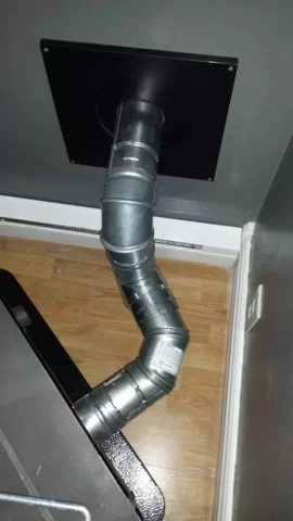

Then I would aslo have to patch my hole and lower the hole in order to go straight from the stove to the outside then 90 clean out then up the rest of the way to to the cap

There are adjustable vent pipes available, you may be able to utilize one for the distance between the stove to the thimble.
pipe out from stove --> 90º connector installed at a 45º angle --> adjustable straight run --> 90º connector at a 45º angle --> horizontal run through the wall --> then either terminate or another vertical run.
I would consider also going with at least a 2' vertical on the exterior if possible, to be able to get a natural draft in place in the event of a power outage.

I don't see why you can't take out the clean out T and and go at an angle up and out. You might have to move your stove around a little though but still be close to where it is.

I have the stove in the corner at the bottom of the stairs. I don't see with where I made my hole with my current setup that I can take the t out and move it outside the angles are too far off I think...
I think I'd have to use a flex pipe which I'm not sure can be used can it??

And as far as I know flex pipe is not code with interior use, unless it is running up the chimney.

So can flexible pipe work or no? That's about the only way I see making it work with the tee being moved to the outside so I can run vertical from it.
Smoke from the joints on the inside? Open your windows and get the house aired out. If you've got smoke you've got a problem.
One of the best ways to test for smoke visually is with a totally dark room...get the stove fired up and shine a flashlight at the connections. Think of it as using soapy water on a gas connection, watching for bubbles. The flashlight beam will show the smoke particulates in the air.
Or, if this is first burn, you may just be getting off gassing from the packaging and oils on the vent kit. But whatever it is make sure you know it's not the stove venting into the interior of the house.
Flexible pipe = NO. Not in the interior of the hose. Only code if used in the interior of a masonry chimney (at least here in MA, not sure about Ohio).

You might want to think about repairing the hole in the wall, and if leaving the stove in that position start with a 45º off of the stove, go directly out the wall horizontally, then the Tee outside and 4' - 5' vertical stack. That will get quite a bit of the 90º bends and extra length out of the picture. It will reduce the number of joints on the interior (no need to worry about the joints on the exterior of the house). Get it away from the windows too.

[Hearth.com] United states pellet stove It looks like if you remove the first 90 coming off the stove and place your clean out t in it's place you may be able to angle it slightly towards the thimble and go up and out.of course it all hinges on if you can find all the right size pipes and move the stove enough to work.

View attachment 184963 It looks like if you remove the first 90 coming off the stove and place your clean out t in it's place you may be able to angle it slightly towards the thimble and go up and out.of course it all hinges on if you can find all the right size pipes and move the stove enough to work.
That's what we tried to say. He might have to rotate the stove to the right some. But we are not there, so maybe not as easy as it looks in the pics.

If it was me I would take the tee and the vertical straight and 90 and put it directly on the stove adapter fitting then move the stove to the left until it lines up with the thimble (looks like 3 or 4 inches) then get the right length straight to go through the wall in one piece (looks like 36 inches). Then if it's out far enough put the cap on it. When done and tested paint it all black.

2 45's,possibly 1 section of adjustable pipe,run outside pipe 1 foot above window height.May have to move stove out a few inches to use 45's.
