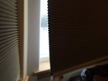

Interesting - any particular kind of curtains, insulated, etc?
I've had really good luck with cellular shades. I've got the cordless kind and they're on the darker side of light blocking. Huge difference in draft from windows. I think these on every window in my house is a big reason I can maintain heat so well.
