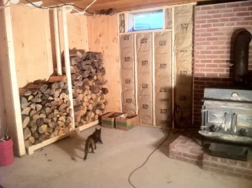

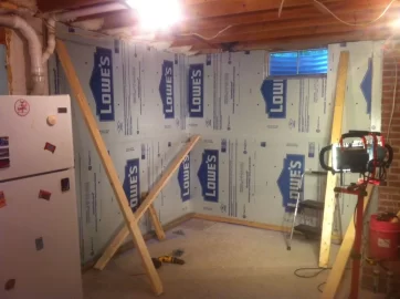

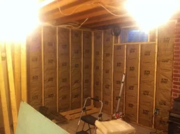

I insulated the walls with 2 inch foam insulation which I glued to the wall. I tuck taped all the seams. I spray foamed at top, bottom and corners. I did the same in between the rafters at the top of the walls.. I added pink insulation on top of the foam insulation between the rafters. It makes all the difference. All they had before was 1 inch white foam on the walls (which doesn't do much to keep the cold out and heat in).
I swear you can't feel a draft at all (except when the stove is running, then you feel the cold air coming down the stairs and the heat going up).
If I could., I would have insulated the cement floor as well, but I don't have much head room. So I'll have to settle for ceramic tiles and throw rugs.
We're expecting some -40C weather for the next couple of days....thank god for that stove!
"Then I built my 2x4 walls and added pink insulation between, then the sheetrock panels."
Is there really a need for pink stuff on top of foam board? I would worry about mold
The foam board against the concrete walls is the moisture barrier so there is no concern for mold.
Also, I believe he packed insulation between the floor joists\rafters around the house. This is what you should be done first (with R30) as you lose a ton of heat in this area (you can see this above the foam board in my pictures).

Usually there are gov't grants to help you with insulation but sometimes they require someone to come in an do a full evaluation $$. The easiest way is to add 2" of blue or pink foam board and seal the joins with red tape, then drywall over top. That way, you have insulated and sealed at the same time. You will instantly feel the difference.
Sort of - mold will form on the foam against the concrete wall if there is any moisture in the wall at all BUT the mold is sealed from the interior by the foam, provided the foam boards are sealed at the joints. So yes, mold will not be a problem but I would still make sure the walls are dry first.
The best and most expensive is spraying foam on the concrete, then it is sealed for sure. Just too much $$ for most people.
The reason for the extra concern is the huge problem that happened with acrylic stucco homes that used foam boards. Many were torn down due to severe mold problems within just a few years of construction. If there is any wall for moisture to get in, mold will grow.
Personally, for me, 2 inch of high density spray foam (R14 or so) was $3600 including tax for the walls and the rim joists. Buying 2 inch foam boards, PL to glue them, tuck tape and the anchors was $1500. Plus I would never be able to insulate the rim joists as well as spray foam did. For the extra $1700 the job was done much better and it saved me 2 weeks of work. lol.
Mold needs air. If your boards are properly sealed, air tight, and there's no air pocket, there's no mold. That is why had I used boards I was going to scrape the concrete to make certain the surface was as smooth as possible.

My real question is why did you add pink insulation between the foam board and the drywall on the wall.
I think he did it for extra insulation. Fibreglass insulation is cheap, might as well add it before closing in a wall. The foam acts not only as a vapour barrier but as a thermal barrier as well. Therefore you simply add some insulation on top, you don't need to worry about condensation, and you double or triple the insulation factor for the cost of peanuts and pocket wool ;)
I forgot one important thing to mention. Mold will not be a problem IF the indoor humidity is kept reasonably low. If, for example, you had a bathroom with an unvented shower downstairs or a grow-op;sick, the humidity would be higher and mold will indeed grow on the foam board. Humidity migrates to a cooler surface and will easily go through drywall. All that is highly unlikely if you have a wood stove downstairs but I just wanted to make sure you are aware.
From what I see, he used fiberglass with a vapor barrier backing. That is far better than using fiberglass alone but the best way to do it is to add another vapor barrier in front of the stud wall prior to drywalling.
We had friends with a very minor leak in their basement water heater connection that went undetected because it was enclosed in a small room. Sadly, mold started and by the time the leak was discovered, black mold was everywhere and they were forced to move out while a crew came in and removed everything to the bare walls and rebuilt the basement.
Exactly.
To increase the R value. It makes a difference when it's -40 to -50C outside.
There is and was no moisture on the walls. The basement walls outside were covered with tar and then covered with blue skin waterproofing.
Exactly. And the foam insulation between the floor joists were sealed with spray foam.
