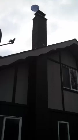

I've got a 12x12 pitch chalet style house with a 20-25 foot chimney leading to my wood furnace in the basement. The chimney runs along side the back of the house, about 3 feet from the peak.
I had to pay a friend go up there and clean it for me this summer. He's significantly smaller than I, and and has greater testicular fortitude than I (I'm afraid of heights! Fell out of a tree as a kid and got dinged up pretty bad).
Anyway, on his way down, he broke my 24' extension ladder in half.
Being that I'm afraid of heights, and that's pretty high up, I need to figure out a way to safely get onto the roof and be able to clean the chimney myself.
Getting a new extension ladder shouldn't be an issue since I'm an auction junkie and can pick one up virtually anywhere.
The two things I think would be very beneficial to me though is something to hold my ladder so it can't sway. Do they make a square bracket of sorts that will slip over a chimney and have a ladder hook on it?
I'm also considering a climbing harness, but don't know how or where I'd attach it.
Any suggestions?

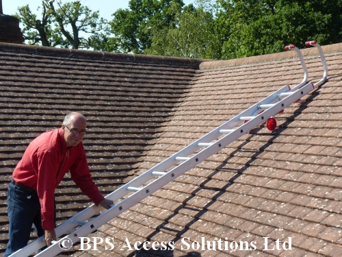

Can you get easier access to the roof from the eave side. Maybe you can get a shorter ladder up to the eave edge (over the rain gutter) and then get some sort of ladder with wheels and hooks. Push it up to the peak , flip it and the hooks will hold it as you "walk" up it. Like a chicken ladder.
http://www.worldstores.co.uk/c/Roof_Ladders.htm
