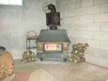

I'm curious to see the results too. Tomorrow makes a week with the MH. My plan is to take the connectors appart and check for build up. I'll also check the chimney.
There are definetely pros and cons to having a reclaimer. The pros are pretty obvious: more heat
(up to 30,000 btu), and faster heating. The cons: unsightly appearance, noise, more frequent cleaning, increased electricity use.
I really miss my quiet basement retreat! Also, I've yet to see the electric bill. I almost feel like I'm cheating, I can no longer say that I heat only with wood because of the electric being used to blow the heat. That is also weighing in on my pros and cons list.

Ok, for those of you who were interested to know the results, it was dirty. But, that was expected. With this MH connected I'd have to clean the connectors once a month. I've been burning a lot of pine in it too! So the results were not unexpected. The next time I clean it, I'll take some pics so everyone can see exactly how much soot gets deposited in the connectors above the MH. Not as much fell down into the lower connectors as I thought. Even with daily scraping of the blower pipes. With monthly cleanings the connector pipes should be fine and the chimney was as clean as a whistle! It was black but had no build up all the way up! My chimney has really good draft, which helps. I've also been burning around 300-400 flue temp as much as possible during the day. I'd say 7-8 hours with those temps. So, to sum it all up, dirty, but not incendiary results! Just as I thought. Frequent cleanings, with a lot more heat. Faster heating and increased air circulation, Which is perfect for heating a house from a basement stove!!!
Good luck to those in the Mid-Atlantic snow storm, burn on!!

next time u clean the chimney, try to burn the scrapings so u get some idea of what chimney fire hazard might be in the scrapings.
Thanks Pat, I'll try that! I still have the debris.
