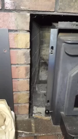

Looks to be set in a mounting box, not sure if it's stainless. No insulation or anything around it, set on bricks at the bottom of the old fireplace.

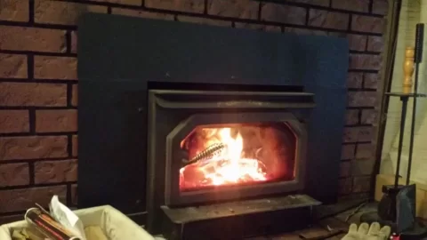

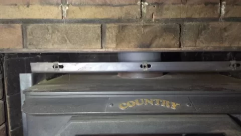

Here are a few pics. What do you recommend?
[Hearth.com] Upgrade old wood insert to cat version? [Hearth.com] Upgrade old wood insert to cat version? [Hearth.com] Upgrade old wood insert to cat version? [Hearth.com] Upgrade old wood insert to cat version?
Open the door and take a picture of the upper part of the inside of the stove. It will be immediately clear if it's an EPA stove.
As far as the other stuff, it looks a bit tight so adding a block off plate may require removing the insert but you should at the very least be able to stuff some mineral wool insulation into the damper area for heat retention.

All above that is stuffed full w/ Roxul. On an exterior install you lose a lot of heat out the back which not only is wasted but leads to a cool liner so creosote formation is higher too. There are good thread here on the benefits and install of block offs and firebox insulation.

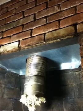

In this pic you can see the upper part of the fireplace. It seems to be mostly black steel, with a shiny block off plate around the flue pipe:

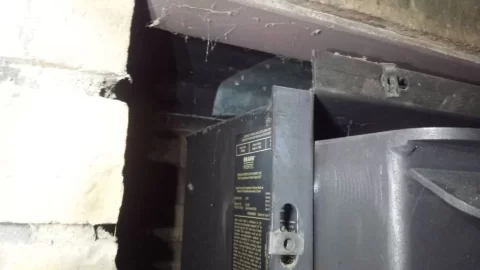

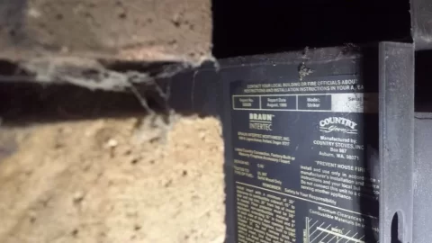

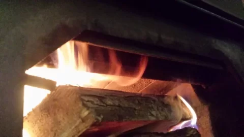

The model says Striker, year 1989. I can't imagine a stove from 1989 being an EPA stove, can it? I have fire in it now, but here is a pic of the inside top.
On the side plate what is the manufacture date listed?

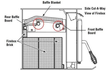

Hard to be tell with the stove full of wood and fire. Here's a side cutaway view of the stove with the secondary tubes circled.
That should be an early epa unit.
I looked closer through the glass. In the pic above you can see there is one tube all the way across (about in inch in diameter, holes in it). It sits right behind where the stove collects for the flue.

Looks like a block off plate is installed. One of the pics I can see sheet metal above the stove. Seems like a good install. Not much room on the outer edges so I'm not sure how much bigger stove you could get in there. Hence the problm with most inserts is you stuck with fitting it in a pre-made hole. Other than what begreen mentioned for a free stander, I don't think I'd bother with an upgrade to a different insert.
Is there a liner hooked to it? Has it been cleaned and maintained correctly? I personally would have the system gone over by a pro or at least someone who knows what they are looking at before burning any more. From what we can see it does not look bad but there is allot we cannot see.

I get up on the chimney, no liner. Just a little topper hat that turns with the wind, on a 10 inch square terracotta chimney. I pulled the insert out, and it has a block off plate, but only a 6 inch or so pipe, with 2 inches sticking past the block off plate.
I ordered a chimney brush, pulled the block off plate, and cleaned the chimney. The angle iron part of the damper is there, and the smoke shelf is in place. I'll have to cut the metal out and break out some bricks if I were to install a liner. My plan is to remove the entire fireplace, flush with the wall, and install a standing wood stove half inside the chimney opening, half inside the room.
