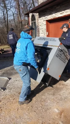

sent 4 able bodied men........turns out they will need them
  • [Hearth.com] Upgrading 1988 Heatilator to 2016 Pacific Energy FP30

But.......things go south fast......after getting unit through the door, the second time lifting the unit with the nylon straps they ran under the carriage, one fails, bringing all of it down in the 18" section between sheets of OSB. Only 4" above the floor, but it left a healthy divot, and put a small bend in the front corner of the surround. !@#$%!!

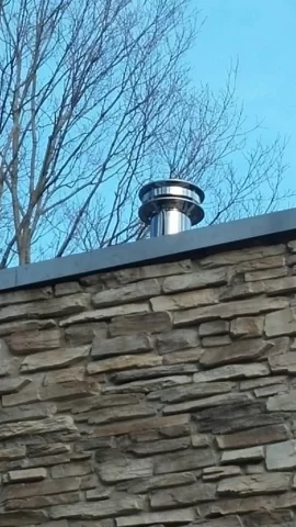

itsy bitsy tiny new chimney... total length ended up being 17'.
