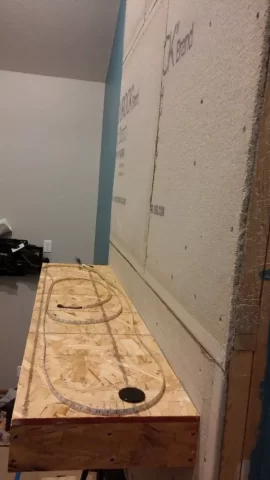

Finished piecing together the substructure of my mantel today. 1/2" OSB and 1"x4" pine form the surface for an oak wrap.Hooked up the flush mount electrical outlets, and soldered together the LED extension. Switched outlet inside the hearth controls the LED strip lights. They will eventually be cut to length and oriented facing upward, but you get the idea of the effect from the pictures.
