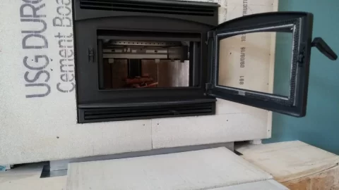

All closed up, ready to rock. Brought the sample home one last time, now that paint and lighting are in place, just to be sure.
  • [Hearth.com] Upgrading 1988 Heatilator to 2016 Pacific Energy FP30
Looking good. Have you lit it up yet?
Looks great!! Can't wait to see it finished.
no fires yet. Am I overly paranoid to wait until the hearth stone is in place first?
Cover the hearth with Durock and it should be ok for a break-in fire.
Reactions: Weaselfest
temperatures are supposed to drop again this weekend and I have the house to myself, sounds like it's time to stink things up
Anybody care to spare me hours of searching on break in fires and give me the Cliff notes version?
It's a steel stove at heart. Just do a small break in fire with 6 or 7, 2" sticks to dry out the firebrick. Let that go out, then go ahead and do a good load of splits to bake the paint. Open a window or two and put a fan to exhaust fumes out one window if possible.

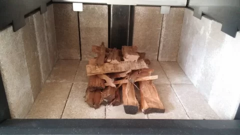

it is finally that day...
FIRST BURN!
Reactions: mcdougy
My blower didn't kick in during this initial small burn. Should it have? Manual only offers cryptic description of " appropriate operating temperature" with no numerical range.
I swear as soon as I hit "post reply" the blower kicked on! Whoopee!
Initial impression: WOW! This thing breathes easy as reported. Igniting one fatwood stick was all it took to get my little stack of hickory going. The air wash system is something to see for the first time. Smoke rolls down, right over the glass, about an inch behind it. The blower is noticeable at my controllers "high" position, but "medium" is a minimal hum and "low" is imperceptible unless you darn near have your ear to the surround. And this is with just the cement board over the top. Can't wait to fire it up a little more seriously later today.
