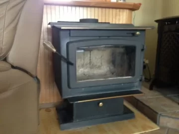

Used Century Stove Worth $450 or best
HDRock
Oct 25, 2012
2,240
Grand Blanc, Mi
Stove in CL add
The guy said he was using it, he replaced it with an enamel stove when he did his living room remodel, he also said he could take less than 450 , he wants to get it sold so it doesn't rust in garage with summer humidity.
Any one know is this a decent stove (Model# FW300007)
What do ya think I should offer ?
I need to heat 1300 sq ft

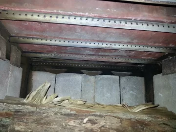

I am wondering if secondary tubes are removable ;?
A problem with the stoves is that the steel baffle is the secondary burn assembly and it is welded in and can't be replaced. Warp it and the party is over.
I have one. The label on the back says it's the 3000 but the firebox dimensions don't match up with the new ones. Tubes are removable and the baffle is not welded in.[Hearth.com] Used Century Stove Worth $450 or best
Good to know that replaceable tubes are in that model.
I have one. The label on the back says it's the 3000 but the firebox dimensions don't match up with the new ones. Tubes are removable and the baffle is not welded in.View attachment 94790
Thanks, and for the pic to :)
I did find the tubes in replacement parts , they hook on with some stainless steel pins
