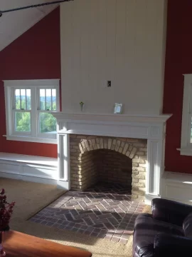

When I built the great room the "fireplace" and it's hearth was sized for the Encore. For financial reasons we never got around to purchasing the stove. Later I went back and verified the dimensions against the Castine and I couldn't get the clearances to work. Although brick, the fireplace is not fire rated and the clearance above the flue pipe was too tight. I don't have the dimensions handy, but if you guys want, I could measure them tonight.
I had an Encore at a prior home and really liked the thermostatic air control and appearance. Never could get that stove to burn correctly though. Would have to burn it wide open for it to make any heat at all. Never figured out what was wrong with the stove/install and with this horizontal run, I'm again concerned about the fireplace performing correctly.
