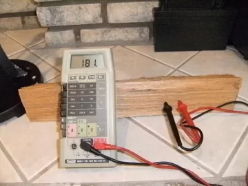

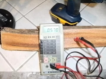

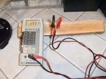

Great thread.. I checked some of my wood today with my Fluke. Split each split and drilled holes 1.25 inches apart with the grain on the exposed surface and stuck the probes in. nice tight fit.
First Pic- White oak 3 years split that's been in the garage for the past year, burned some of this last year and man was it nice. 181 meg?? I guess that means its really dry.
Sec Pic - Red oak 10 months split, stacked outside with top covered. .177 meg and i can feel the dampness on the exposed wood.
third pic - Red oak 5 month split, stacked outside with top covered. .057 meg and its really wet on the freshly exposed surface
