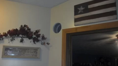

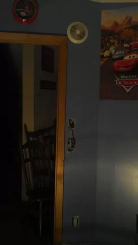

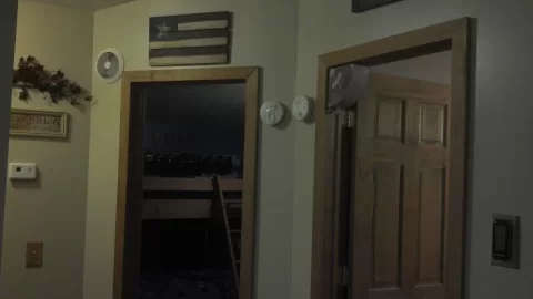

I installed a Broan through the wall fan in my Sons room as an experiment. It is a 90 CFM fan, that can be hooked to a variable speed switch, so you can put it at your desired level (sound level).
With the unit blowing in the room, there is a great deal of cold air coming from under his door. The gaps under our doors are around 1.5", to accommodate for the cold air return (when we used the furnace/yrs ago). After a few nights of running it and his room staying within 1-2* of the hallway temps. I can say that I will be installing 2 more in our house. 1 in our room and the other in my daughters room.
They were $42.00 and I might make a suggestion to just buy your own wall switch. There switch is of very low quality and is going back. I bought a standard wall mount dimmer switch for $5.00. His fan chugs along at night.
Broan makes several units that can go through the wall. With this being at the smaller and cheaper end of there line-up. Here is a link if you wanna take a peek.

Here are a couple pics of my Sons fan
Switch was not installed here. I was giving an update for another member and had to take some pics. It was quite simple. As long as you install it into a wall cavity that has an outlet in it (For your power supply), you can easily find the romex when dropping it through the drilled hole. (6" hole saw from HD did the trick, really quick)
