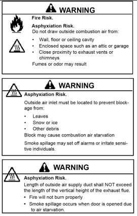

If chimneys exit beside each other, one potential problem is the OAK chimney grabs smoke and CO from the exhaust chimney and brings it back down to stove. Any OAK pipe leakage would discharge it in your house.
Correct. When in doubt, RTM.
[Hearth.com] Using two chimneys for a closed loop system.
Yep. I figured that would be the case. I will leave that idea alone.
It was a good idea though, some gas appliances can be installed that way
