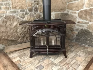

Yes. Quadrafire has done the best with it in my opinion. Jotul has a top loader, it's not as useful as the quad.
I think they are a prettier stove than VC too.
